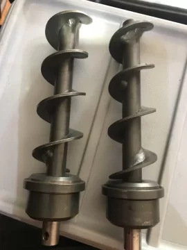

The new auger has slightly smaller diameter fins and 3 weld spots with an extra one in the middle instead of just 2 at each end that the original auger has!!
The auger bearing is nice and quiet too.
1st pic - new auger on right and old auger on left

A bit of deflection in the old auger maybe?
Maybe, the fins not being held down in the middle and the diameter of the fins being a bit larger could easily expand with the heat. A cheap fix would be to grind the fins down on a bench grinder and adding a good weld in the center. However any uneven grinding may make the auger out of balance so a new auger is the best solution. Since the bearing was making noise that was not good either.
