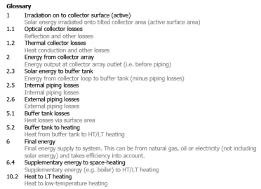

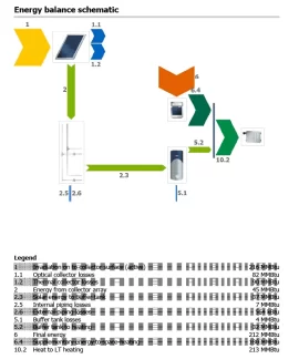

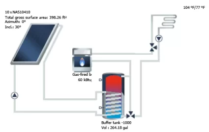

In the solar industry we have simulation software to show the energy movement. Here are some of the printouts from the Valentin T-sol program. I was amazed how much of the energy slips away from the collector to the final heat emitter. I would imagine the same for wood fired energy transfer.
It's not just about the wood to water efficiency, but wood to load.
