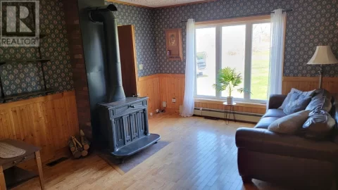

Here a picture of an old wood stove in a farmhouse in east PEI. Looks really old setup to me. Anyone
know what it is? It must gobble wood pretty good. The chimney is brick and here appears to be something
sticking out of the top of the brick on the roof, but the picture is zoomed out. I wonder if they has a steel stove pipe inside
the masonry chimney as well. He must get a lot of heat from the stove pipe as he has metal on the brick.

Its called a Franklin ,yes really goes threw the wood ,most of the heat goes up the chimney !

Hey it says it was invented by Benjamin Franklin. I find that hard to believe?...oh I think it was just named after him according to wikipedia
Might be a heat shield...the brick may be attached right to wood framing, so clearance to combustibles rules not met...and yes, those things are forest eaters!

I thought a masonry chimney had to be self supporting? Oh well, I'm thinking this farm house is pretty old. I have no idea why they would be trying to sell with that there. It obviously it can't be used if you want insurance. That is just one more expense for the buyers.

Ah, I see now that is the chimney itself...I didn't blow the picture up before and thought it was just brick laid up to be "fireplace-esque"
Hmm wondering if that is fake brick. Looks like it could be in the pic as it seems like there are thin ends on the corner bricks making me think they are thin brick "Tiles".

No, I'm pretty sure it's real as in the other pictures of the exterior there is a masonry chimney. If you were just going to have a chase and pipe there would be no exterior square masonry chimney. However I think I can see round stove pipe coming out. Maybe in the beginning 1894 or whatever, it was just masonry with some stove pipe to get it from the stove to the chimney. Then maybe after a few chimney fires they upgraded and put the stove pipe in it? I don't think it would fit? I can't get better pic's of the exterior. He probably figured he could heat up that metal and get more heat out of the stove pipe.

I only see one house chimney, but if he has oil, there must be another chimney.

That looks like the clay liner sticking out the top. And just because it's real masonry doesn't mean you can't have brick veneer over it. That does look like brick veneer to me, which is real brick but only 1/4" or so thick.
Although it is not legal, many setups exist with an oil burner and a wood stove vented into the same flue.

I suspected they had the oil furnace vented into the same pipe. I thought I saw a round pipe sticking out of the exterior chimney as well.
I wonder if he could use the wood and oil at the same time?

Yes they most likely use the wood and oil at the same time. My grandpa had a setup like that on a 8" clay lined chimney. Oil in the basement, woodstove on the first floor.
