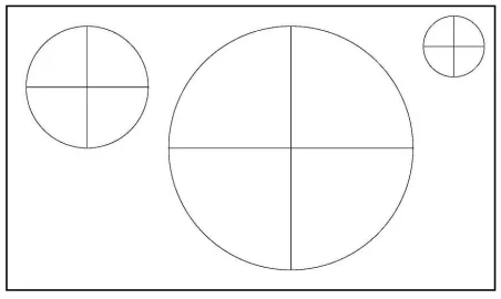

I'll attach a quick sketch showing 6" (stove), 12" (wide open fireplace), and 3" (gas - or is the oven not gas?) cylinders inside of a 14" x 24" rectangle. Seems like your lath/rebar/blanket/cement idea would be messy, fragile, and potentially would do more to disturb your house's character than a simple set of liners, thereby allowing you to selectively install / blockoff flues as desired, without causing code issues.
