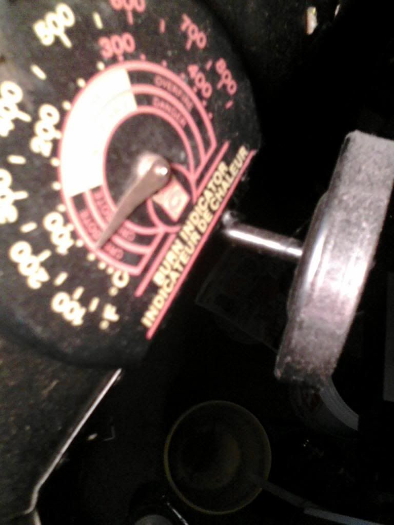

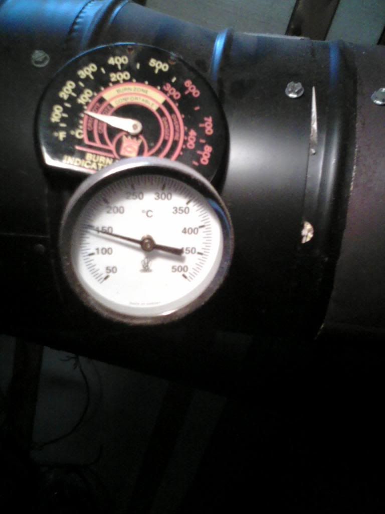

My probe is different than discussed in those. I just took a couple quick pics:
[Hearth.com] Thermomater  magnetic or ir
Just lit a fire so temps just building - usually it's more like 200c on the probe & 100c on the magnetic. Those bimetal type probes talked about in the other thread sound like all kinds of trouble.

Came with my boiler. Made in Sweden, I forget now the brand - I can check it again when I go back down there.
I suspect they can be purchased from my boiler vendor & site sponsor Smokeless Heat. I don't know how much they cost but would be curious about it.
I was kind of shaking my head at that other thread - I would expect a probe thermometer to read the temps where the probe is located, and that the temps where the guage head is at would have no bearing. Sounds like a very badly engineered product to me - and very misleading & potentially dangerous. I had no experience with them until I saw that thread - I guess I won't be so quick to simply recommend a probe thermometer anymore.
