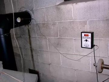

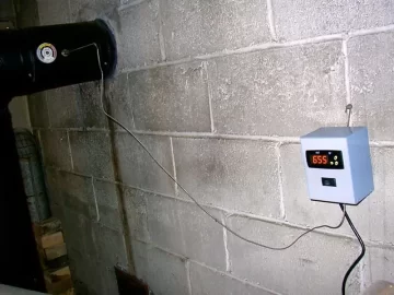

I think a temp monitor/ alarm is a great idea. I have 2 of them. One is an IMS unit that I got for free. The other is one I built.
I like them much better than a thermometer. The high and low temp alarm feature is really useful, you can burn kiln dried wood like pallets without worrying about over firing. You can get a fire started quickly and get the stove up to temp fast. The low temp alarm can be set to let you know when it's time to put more wood in the stove.
I think if you wanted to detect a chimney fire you should install a probe at the top of the chimney.

Nice job with yours.
