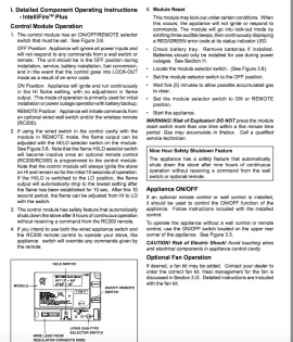

I know nothing of your stove but just looking at the online manuals it seems like what you want to do might be possible. According to the owners manual if you set the selector switch to remote the stove can be controlled from a hardwired wall switch.

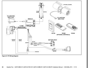

The wiring diagram in the installation manual isn't specific about the function of the switch in the lower right corner but I'm thinking you would replace that switch with the programmable thermostat. If you have the selector switch in remote and can control your stove by touching the red and brown wires together that should prove my theory I would think.

The switch on the lower right is the rocker switch on the stove. I was thinking of disconnecting the switch and wire in the thermostat. Unfortunately it would require cutting the wires (which I really didn't want to do in case this doesn't work) and the sheathing on the wires is so brittle it's starting to crumble. My luck, I'd screw it up and cause a short somewhere.
