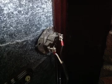

130 degree dryer thermostat. Turns off and on a fan about 4 foot away to move room air. It helps a lot.
  • [Hearth.com] Thermostat on Blower
I bought one for my NC30. It's called a snap disc and mine is adjustable. Don't touch those connections, that's 120 volts all exposed there and awfully close to energizing your heritage!
I moved it from the back to the side for the photo op.
