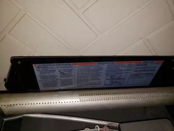

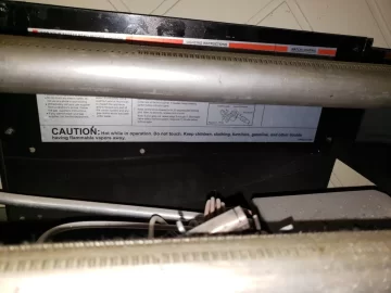

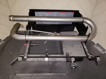

Hi,
I am looking to buy a used ventless fireplace off someone online and they don't know if it is thermostatically controlled? Is there any way to tell from pictures? See pics. Thanks!

Do you have a model # or brand somewhere on the warnings on the back of the model you posted? That'll help us figure out if there's a thermostat mode you can utilize if you are confident in the purchase

Can you get a pic of the control valve? I don't think you are going to be able to add a thermostat to that. And I agree with the statements of the other servicemen.
