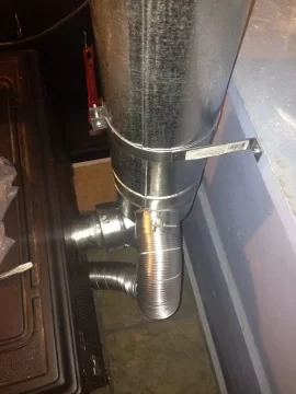

Dampness and moisture is the pellet stoves worst enemy!
That said, the Selkirk DT venting is the best cure! I was getting damp caked ash in the burnpot every morning from the morning dew! Finally I put in the Selkirk Masonry Conversion kit and Bingo, problem resolved! Seeing is believing! ! !
The outer wall brings in fresh air around the hot flue and warms the burn air. There is no measurement or claims of how well this works or even if it does work. I just see a huge difference in my particular case!
See pic below of Selkirk Up & Out
Masonry conversion
The outer wall brings in fresh air around the hot flue and warms the burn air. There is no measurement or claims of how well this works or even if it does work. I just see a hhuge difference in my particular case!
There are measurments,has been researched a lot.Preheating cold combustion air is way more efficent,any type of burner.Notice harman pushing their system?Because it works,Now piazzetta is pushing it for their stoves.Direct vent gas heater manufacturers figured this out years ago.But I briught this up on oak threads,nobody seemed to believe me.Bixby knew it also.List goes on.

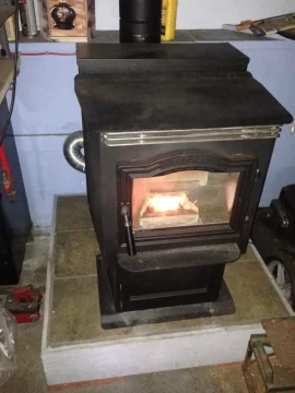

X2, We agree and people are beginning to realize this. Heck I even have DT on my garage heater, I luv it!
