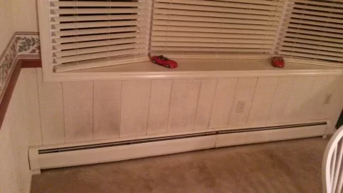

This is what I have to work with. These are in every room in the house. The pipes are all there. [Hearth.com] Thinking about Buying a Boiler...
Where do you start, well with a budget. A general plan, testing your current radiation, heat loss calc, sizing or changes to meet calcs. And then check out the most expensive boiler and correct install and cry at the price and ROI math. Maybe you get lucky, never know. You can do anything with the current baseboard you have. Add fin tube if your short on btu footage, or do a parallel or series run for low temp apps.
Good luck
