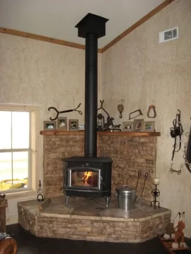

Do a search for greythorn3's hearth build for his Englander 30. He used heavy gauge metal 2x10's and durock if I remember correctly. Then tiled over it, but you could do stone veneer, tile, or whatever. It turned out really nice and was pretty tall. I'll do a search here in a bit and see if I can find his thread.

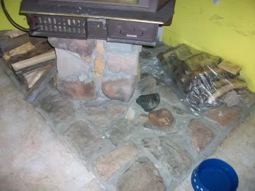

2" of concrete, fake concrete stones and 4 cinder blocks. Just some I through together at the last minute.

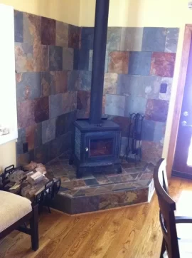

Here are 2 from here that I love.

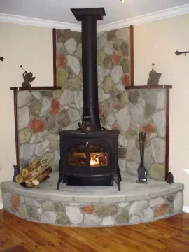

I went with 8" off center with 2x8's. Two layers 1/2" durock with screws on bottom layer to secure to studs, mastic to secure top layer on. Very, very stable and probably a little overkill.
That looks good.
