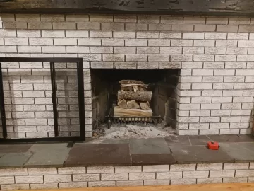

Hi,
Thinking about converting existing masonary fireplace and putting a wood stove in it. I burn a lot of wood in my fireplace and love it. But with natural gas prices going up and my decent firewood supply, I'm thinking a wood stove would be beneficial and eventually save some money.
Current fireplace is a center of the home
interior fireplace with 3 flues. Center flue is the fireplace, one is unused and the other is for the boiler/steam heat.
Fireplace dims are 27Hx31Wx22 deep. A local place has a true north TN20. From research, it seems like a decent stove for the price. The reason I want the stove is because we may build an addition down the road and I can take the stove out and put it in the addition and have my open fireplace back.
I had an installer come out and he didn't really have any concerns. Biggest, is the flue collar height being a little taller then my opening but the tile on my hearth can come off (dont really like it anyways) and he said he can do some notching in the firebrick to slide it in.
The house is a 1900 square ft ranch on slab. The chimney goes through the attic. Here is a pic of fireplace
So, this stove will be a tight fit and I'm hoping for some insight if I might be disappointed.
It's a pretty good investment and I'd hate to drop some money and have buyers remorse. My concern is I'm trying to hard to make something fit that shouldn't.
What do you think? Will I be pleased with the heat output and savings from boiler not running as much?
Any other concerns with my set up?
Thanks!

Seems like the TN20 insert would be a better bet. The TN20 is a good stove but 28 1/8" tall and the opening is 27". That's too tight. The Jotul F45 with the short leg kit would be a better fit for a freestanding stove.
In order to put a stove in the fireplace, a stainless liner would need to be installed, and ideally, a blockoff plate installed in the damper area. This alone will be a fair chunk of change for a temporary setup.
Im leaning toward the stove because the insert is so permanent. The addition is not gonna happen for awhile if ever so the stove would stay for awhile.
What is the downside with such a tight fit on height? Once the flue collar is in the fire box, the height of the TN20 is 26.25 inches. I shoukd have decent room on the sides, just the top will be tight. Are there performance issue? Will I still get good heat output?

The insert is no more permanent than a wood stove. They both need the same infrastructure.
3/4" clearance over the stovetop is not much. The stove needs more for the blower to work well.

So, with this tight squeeze at the height, will I not get much heat output?

Correct, but the insert could be sold at that time and an appropriately sized freestander purchased then.
Radiant (unshielded) stoves are not the best for fireplace installs. The Jotul F45 is more convective in design. The blower system in the TN20 blows across the top of the stove to convect the heat. It should have some free air space above the stovetop to do this efficiently.
One thing that might? be possible could be to install the TN20, without legs, on cement half-blocks or bricks. That would lower it considerably. Care would have to be taken to not block any air intake or air control mechanism and yet fully support the stove. I have not studied the bottom of this stove thoroughly to determine if this is a good option.

Any idea how the tn20 stove would perform without the blower? Would it still throw a good amount of heat?
Seems like the tn20 would still stick out of the firebox a decent amount on the mantle so I was hoping that would put out more heat?

Not as well. It will throw out a lot of heat but much of that heat will be absorbed and transmitted to the outdoors via the cold exterior face of the fireplace.

It's an interior chimney right in the middle of the house, not exterior. The back side of the fireplace is the kitchen.
Does that make a difference?

My advice is buy now for the current location. Get the best fist for now. You will enjoy an insert more asi it’s performance will just be better than the free standing stove.
The TN-20 is about the cheapest good stoves come.
Now I have a free standing stove in my interior chimney. I use the blower on low 75 % of the time and on high when ever it’s cold out. The interior chimney helps and makes it kinda like a masonry heater but it’s not. It’s still a convective stove in a very confined space.
I have 3” from the stove top to the lintel and that’s as low as I would ever go.
When you get the addition done get the right stove for it. May you want a different look or maybe an alcove with certain dimensions. Maybe you realize heating with wood isn’t your jam.
I have an insert too. You don’t have to install the surround of you like that stove look. It really is the correct choice for any fireplace with height lower than 28”.

The UL testing is for a combustible surface underneath. No doubt this would be an off-label use, but it will be sitting on a fireplace hearth which is rated for fire directly on it. This is assuming that the fireplace was built in accordance with the UBC and NFPA 211. The legs should be put back on when the stove is moved to the new location.
If one wants to be totally by the book, Buck makes stoves that can be used with the legs removed when put in a masonry fireplace.

I really appreciate the insight and advice here. I'm steering sway from the TN20 and found a local place that does carry the Jotul f45.
I would have to order the short leg kit, but do you think this would be a better option for my fireplace? Or am I still reaching to make something fit that shouldn't?

That's a good stove and heater. It is documented for use in a fireplace. Note that to use it later as a stove out of the fireplace, it will need the regular legs put back on.
