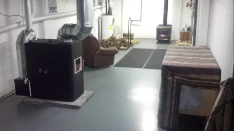

Heat will find the bedrooms.... If it doesn't? ? Then make it move by using fans (through the wall fans). I have a couple different models installed. If I had the pick one, it would be the Tjernlund Aireshare AS1. By far the quietest fan I have seen. Moves 75 CFM and looks pretty nice to. Here is what it looks like from both sides.
Also have 90 CFM Broan fans. They push more air, but are louder than the Aireshare.
  • [Hearth.com] Thinking about purchasing pellet stove??
