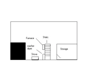

Trying to come up with a way to move some of my excessive basement heat upstairs. I leave the basement door open but the stove is kinda blocked. What kind of fan would help me? I've enclosed a NOT scale drawing of the basement. Maybe it will help.. By the way, I have NO fans currently down there and its a 9ft ceiling, plain rafters, un finished!

Do you have an air handler/furnace in the basement? You could cut in some registers in the return duct and run the unit on fan only.
I do and thats a great idea. Maybe I can get my AC buddy out this weekend to do that. It stays overly warm in the basement but the heat has a tough time traveling up. The upstairs stays fairly cool lately and the basement is a sauna..

as pook mentioned,
if you can move the cold air down the warm will move up the staircase better.
also is that furnace forced air? that would be perfect to run a fan on.
