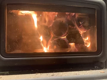

Maybe post a pic when the stove is loaded and been burning after you set your air to your normal desired setting and waiting 15-20min that way we can see the firebox and judge the flames and coal bed.

Here is a few pics , the first one is reloading , the second is before I shut it down and the third is with the air open about 3/4”

It's not overdraft, if it was the stove top would get well over 700F with how full it is being loaded. How are the stove top temps being measured?
I'm definitely leaning toward wet wood, those smallish (I assume spruce) rounds in the third pic look suspect, generally mine have a split in them once they've dried below 20%. Can you split some of those and check the moisture content, make sure the wood has had enough time to come up to room temp, up to 24hrs can be required for the wood to warm up if stored outside.
Im scratching my head here, your fire behavior seems normal to me, I honestly thought that with the air control closed at 3/4 you would still be seeing vigorous flames in the firebox, perhaps the wood isnt as dry as you think (maybe a bad moisture meter, or one with a weak battery?)
BTW fir those viewing, the pics look like its right to left.
