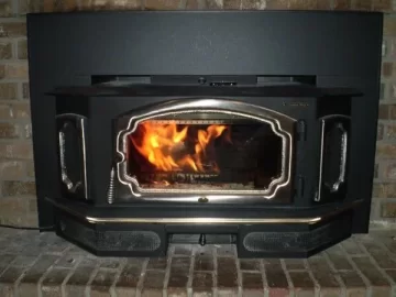

Here's what I have.. a Lopi freedom bay insert. Nice view of the fire...
  • [Hearth.com] This is my POS fireplace, what to replace it with
