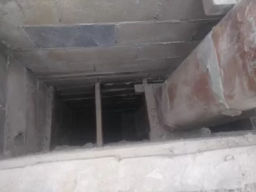

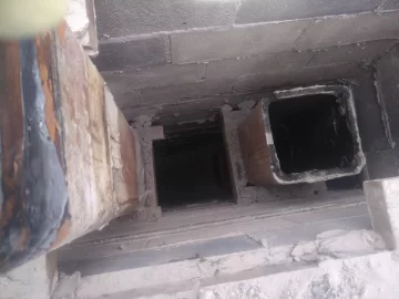

Helping an employee pour a crown on his chimney and found this when we pulled the old crown off. Yes those are the ceiling joists running through the chimney and in direct contact with each of the 12x12 liners. Fun fun fun. There are many more problems that will need addressed by tearing the chimney down below the roof line as well.
[Hearth.com] This is why you always insulate liners. [Hearth.com] This is why you always insulate liners.
And yes we had done a full inspection on his chimney when he bought the house. There was no way for us to know what was there

Wait, so it was just the tiles acting as the “chimney” with no brickwork around it?
Yes there is brick that is a picture down inside the brick from the now open top
