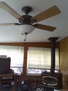

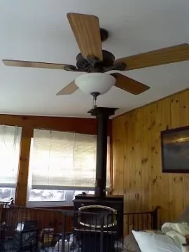

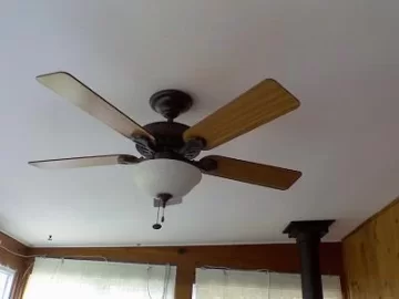

Well, it is finally up, second one this year and I decided to put this one where it counts (first one in my sons room).
As you can see by my pics, one of my stoves is in a 19x15 Florida room with mostly windows. Now they are all good quality windows but still windows. With the Avalon Olympic in here I have obviously a tremendous amount of heat for this room. Adding a ceiling fan should help to circulate more heat right? I have 2 small door fans to push out some but I figured this will circulate even more

Nice job. I have all 18' ceilings in my first floor and without the fan on all hot air goes up. With it on it all circulates evenly. They make a big difference.
The ceiling fan, run on updraft, will establish a vertical circulation in the room where it's located. Roughly toroidal...think donut...pulling relatively cool air up from below which will then wash across the ceiling in all directions, displacing the warmer air above out to and down the walls to the floor, where it will begin another lap. This will destratify the air (temperature-wise) in the room, greatly improving the comfort factor down where the people are. It will do very little to move air out of the room it's in, unless the floor plan is such that the toroidal pattern isn't established completely, like if you had a lofted second floor wide open to the lower room. A ceiling fan is not an effective mover of air horizontally. Rick

Improving comfort is the number one priority, it's too hot sometimes (most of the time?) and I don't like to open windows if I can help it to cool the room down. I am sure the combo of ceiling fan and small door fans will help enough. It is amazing how with the door fans going (might just splurge this year and buy one of those whisper quiet door fans) the heat goes out the room and across another even going upstairs because of the "chimney effect" as wildland firefighters call it.
Thanks Ric, I figured the ceiling fan would just help make the room more comfortable

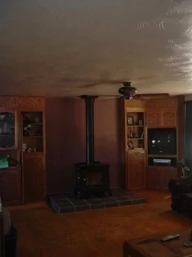

My ceilings are 7' above the floor. The ceiling fan in the photo is as close as possible to the ceiling and no light kit to keep it high. I can also touch my ceiling but I have to use my arm and hand. Don't stick your arm into the fan.

I am in the same boat (as shown in my pictures), ceiling about 7-71/2 feet. The fan blades are just above my head, maybe 3 inches tops. If I don't pay attention, which happens everyday, I will smash into the light kit. Oh well at least the hearth gate will stop me from going head first into the wood stove :cheese:

I was going to get one of the 50 dollars ones from HD or Lowes but I decided to spend a little more and buy a Hunter. One thing I will say is the "5 minute Fan" by Hunter is not really worth it. The quality is OK but not as good as a "regular" fan from Hunter. My sons room has a nice 44 inch Hunter which is smooth as silk even on high. I bought this 5 minute fan because the blades matched the walls. The only real benefit I see to the 5 minute fan is the blades assembly, it is just a little lever that snaps them into place (not worth it again) None the less it still works very well and the most important reason was to get the stuffiness out of the room in the winter and summer. I wanted to get the 52 inch but way too big for the room, it looks huge as it is right now (50 inch)
This fan I could not use the flush mount because my ceiling is angled very slightly
Overall I am happy with the fan in room, should have done it last year, but I am still a home improvement rookie, baby steps :cheese:
