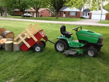

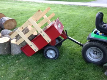

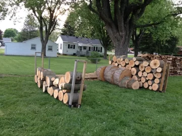

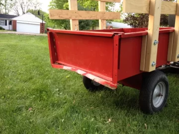

Did a little moving around of my recent CL delivery yesterday. I was starting to make a dent when my trailer decided it was done!!! At least my custom rails didn't break! Looks like i'm gonna have to do some strengthening on my hitch.

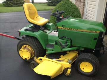

It's a good thing I'm picking up my dads old John Deere tractor and trailer today!

That 445 is the ticket!
For sure! It's got a front end loader too! I'm gonna have some fun with that! I'll post some pics in 'gear' when I get it.

Truly a dump cart now ;)

Pic #2 and #3 just too funny. I mean what the heck you made the sides for it and its kind of cute. This will be one to remember! ;lol

I sure will remember it! Lol. It will haul again, just need to do a little beefing up on the little guy.

Nice stack of rounds.
To be a : "Nice stack of splits" when ?
When wood is cut in the spring, getting it split soon
is important so it can start to dry.
(maple & birch especially) Very wet inside & starts to mold fast.
For sure with a dump trailer you must load heavy in the front and very light in the rear. You can beef that tongue up pretty easy though.

whats that on the rear wheel/hub of the john deere...ive never seen that before
Ballast.

I should have in all split in the next couple weeks. A little at a time.
That's almost exactly how I broke mine, a similar model $50 yardsale rustbucket. The bolts holding the box on popped also . Re-bolted, jumped up and down on / sledged the tongue roughly back in place and reinforced it with a chunk of PT lumber. Then I resumed abusing it.
Reactions: Trilifter7
Might be time for a "C" channel upgrade on that main frame tube. Or, you could get a stick of heavy guage 2" square tube at your local metal shop and have it heated and bent to the contour you need.....
Yep, lesson learned there. It'll be good as new soon as soon as I get that hitch fixed. Heck it will probably be better than new!
