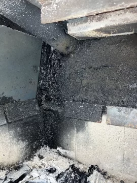

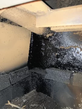

I burn my princess on low 99% of the time with very dry low btu woods like Doug fir and maple from a shed. The cat stays nice and hot, the probe for the flue meter stays brown and dry but the firebox can get pretty icky. The wet looking firebox deposits on the bare firebox steel can cause corrosion, especially in the corners, and this is what the deposits look like. To remedy this I’ll need to burn a half full firebox of wrist sized splits on high. That won’t clean the glass but it will dry out that tar stuff and allow it to flake off.

Try some Cre-Away, if you can. It may not be good for a catalyst.
Nope. Not into burning trash in my cat stove. High heat will burn it out. Once per week is the BK recommendation.
I told you about the wrong product. This is the one I meant to tell you about that is safe for your catalyst.
Your right. You shouldn’t burn “trash” in your cat stove.
Might want to give the old time adage of burning hot once per day a try as the pictures prove once a week only burns it out, but doesn’t prevent it. If you prevent the build up you won’t have to worry about corrosion eating holes in the corners of your stove. Prevention seems the key to maintaining stove life, not removal.
Interesting. I have build up in my corners too but it’s not shiny like that. Mine is thicker and duller colored. If I poke it with the fireplace poker it falls off. Probably just because of the different wood species.

I get the same in the back of my firebox. I was told it’s pretty normal way in the back like that. Usually after I use a scoop of creosote removal on the fire it flakes right off.
Do you need to burn it on high with that scoop, or just a normal burn?
That's substantially cleaner than one of my fireboxes, which only ever sees 24-hour cycles (low burning). I'm not losing any sleep over it.
My take on these stoves is that they're not exactly family heirlooms. They're just another appliance, like any refrigerator or dishwasher. Use it as suits your convenience, and don't hesitate swapping it out when it's past it's prime, or the next better thing comes along.

As a follow up, it’s supposed to snow tonight so I let the house cool and then did a clean out burn to demonstrate how this tar converts.
The fire only lasted about 2 hours and was log cabin stacked fir splits about the thickness of my wrist. I kept the stat pretty high but kept the cat under 1500 and the chimney under 900.
The tar puffed up like popcorn and popped off like a big sheet of beef jerky. Clean metal underneath. The bricks didn’t clean up. In my experience there is no accumulation behind the bricks.
If I repeated the high burn load it would further degloss that metal. That’s what I do in spring.
