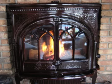

Does the glass stay clean on the Jotul for the most part?
Both are great stoves. I would consider the flexibility the PH allows with the cat. Don't know your location, but you will probably benefit from it with a well insulated, tight new house, especially in the fall and spring.

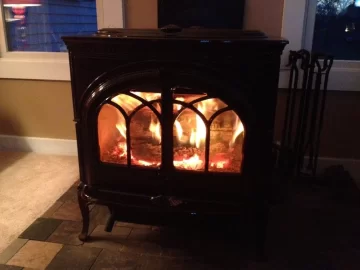

So far the glass has stayed nice and clean. I've been burning close to 24/7 since my installation eight days ago. At first when I was doing the low temperature break-in fires I got some soot in the bottom corners of the glass, but as soon as I was able to start burning hotter fires all the soot burned off and the glass was clear again. A few times there has been a small amount of ash clinging to the lower edge of the glass, probably from a log shifting and splashing up some ash. In the morning when the stove is relatively cool I've just reached inside through the side door and wiped it off with a handkerchief and it was like new again. I haven't opened the front doors since I built my first fire and I'm doing all my loading through the side door.

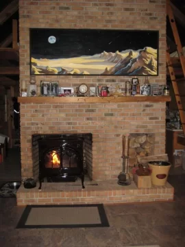

We love our F600. Heats very well. I clean the glass every 10 days or so just to keep it free from fly ash. Never had any black on it. I have a pretty good wood supply and burn hot. I have been using it for since January 2012 and after about 10 hours have 200* + temps. I was looking at the wood stocks but found this one at a closed stove shop and got a deal that I couldn't pass on. Never had any regrets.
  • [Hearth.com] Thoughts on Jotul F600 or Woodstock Progress Hybrid?

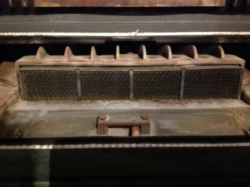

Not cat issues here..... Here is the cat today after 3 weeks of 24 x7 burning, clean as a whistle.
