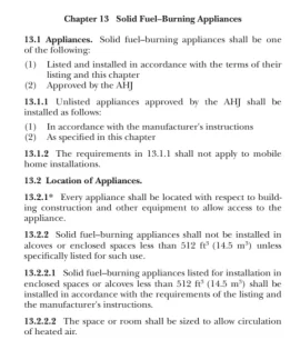

Chapter 13? Essentially enclosed space < 512 sq ft. Although NFPA is voluntary, and so I want to find the local ordinances that say they follow this code... which is where I'm struggling.

Wait, I misread. It is 512 cubic feet, not square feet. That's smaller than my rooms. That's an 8' x 8' room with 8' ceilings.
My bedrooms are ~350 sq ft, 350 sq ft, and 280 sq ft, with 9 foot ceilings. So 3,150 cubic feet, 3,150, and 2,520. 5-6 times larger than the NFPA requirements.

I read this, as several others here do, as there being an exception for wood stoves, not the other way around. If you think what you posted makes your case, I have news... You proved yourself wrong.
Our regional building department approved wood stoves installed in bedrooms without even batting an eye, and I have seen lots of wood stoves in bedrooms, and often in the transition area between the master bedroom and master bath, so that you could take a hot bath in the ambiance of the wood stove flickering.
It is not meant to prove or disprove what I said it's mean to provide accurate information. And yes it gives an exception for woodstoves if it's an old leaky house or if the sleeping area isn't a confined space. That's the code plain and simple
