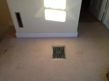

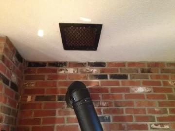

we have a floor register/vent directly above out stove. it lets alot of heat upstairs with the stair door open. were thinking about putting one in the bedroom to serve as a return vent for cold air to create a convection currant. it would be at the opposet end of the hose. the cold end, farthest
i see that people us fusable link fire dampers. where do i purchase these? [Hearth.com] through floor vents[Hearth.com] through floor vents

I would personally check with the local building inspector before proceeding. That first picture looks like it could potentially be dangerous.
why do you think it could be dangerous? that vent has been there 100 years. the building inspector inspected my dutchwest install in the same place and passed it.
Good enough, hopefully it will be standing 100 yrs from now. If your building inspector and you are comfortable, fine.
I personally think it is a questionable practice that the stove pipe is directly beneath, and aimed, at an opening into another room. CO and fire could possibly (though I agree not probably) be directed into room above, thru the vent. If I were sleeping in the room above that the vent communicates with, I would want a CO and fire alarm in the upstairs room.

the room above is a hallway.
when it comes to CO/smoke alarms, there are 7 in our 1800sf home. one in the basement, 3 on first floor and 3 on second floor.also, just plain smoke detectors in the bedrooms. all co/smoke detectors are interconnected. we also have a huge fire extinguisher in our bedroom.
i'm going to be installing a fusable link duct above the stove for safety though.
Sounds like your in better shape than alot of folks so i wouldnt sweat it. People who have burnt wood for years dont get real nervous but there are some people feel more comfortable with all the latest codes and such.
