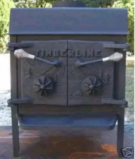

Your stove look like this?
  • [Hearth.com] Timberline Airtight

I had the single door version of that stove for 26 years. What a creosote monster. My father in-law had the double door and got to the point where he was afraid to light it. It burned way hot!
Jim
We had one of those back in the 70's. It did a good job considering that it was located in a horrible location for heat distribution.
Seems to me that the clearances were around 30 or 36 inches but I could be wrong.
