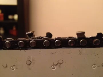

That is what I did and it cuts ok but nothing great. Here is a picture of what the chain looks like. The difference is my rakers look correct. Hope it is OK to use this picture as it is from another thread.

I'm not sure what the issue is with this thing. I looked at the instructions, clamped it on the bar, and went to town.
I got mine secondhand, and the pawl has been damaged by the cutter, though not enough to affect operation. The only way I can see that happening is with improper setup and use. Yours might be damaged too much. I think that was the problem with the one where you got the pic.
The knobs on mine are plastic. I haven't needed too crank them with pliers yet. The previous owner had apparently gotten a pair of aluminum knobs, though. They are still in the case. Maybe the aluminum ones are what they put on them now?
If you are that far back , maybe try a 5/32 burr .' it also looks like your burr is riding very high in the tooth.
Hello, my cutters are not that short I would guess they are about 95% left. I have tried getting the burr/jig lower but then you can't pull the chain thru to the next cutter. I have used one of the jigs that uses a file and don't seem to have the trouble. The Timberline looks like it will do a great job if I can get it working. I'm starting to think like you the burr is to large.
Don't know what to say here ,as I've never had a problem with mine . Maybe use a Husq file guide or something to get back to a normal profile ,and go from there.
mount it up on your bar and chain, exactly as you would to sharpen it, and take a pic. We'll go from there. It sounds like it is not seating down on the bottom of the cutter like it should......
Sorry can't take a picture but only with my Cell phone and it looks BAD. What I did was take my Dremel with a 3/16 burr and lowered the hook/curve right down to the link. Then went back to the Timberline and tried again and it looks good. Will have to see if it keeps working or if I'm going to have to grind the chain down again. Right now it cuts great and even went down a little lower on the rakers and taking good bites without grabbing
