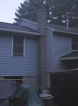

Figured I throw in some pictures. The outside one is a little dark since it's been pretty dreary here today.
First attachment is of the chimney
Second attachment is the area for the stove.

basement location, outside block chimney. Man you have your work cut out for you.

This will be our first winter in this house, so I'm not really sure how the location will work. We loose power around here in the winter during big storms. So it needs to be able to do it's job and keep the place from freezing up. When there is power, we have an oil furnace as well so it's not like this is the only heat source for the place. Are you thinking that we will have cold chimney issues?

The potential for a colder than normal chimney is another reason to think about a non-cat stove in this case. Of course, you could line the chimney with 6" stainless and pour insulation around it. A non-cat puts more heat up the flue, so that can tend to keep the flue drawing better.
