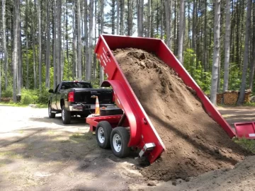

I use this 12000gvw dump trailer. Where you are only 9 miles away, just cut what will fit and what the tractor can handle and load it up, bring it home, dump and go back for more. Might work well in your position.

Dump trailers are made for just that, dumping. They do not work well to haul equipment for a few reasons. First their height, the ramps need to be long or they are too steep to SAFELY climb. Second, the axle location usually is too far back to properly load equipment and distribute weight (too much tongue weight). Third, many lack proper tie down points and side height can make securing a load hard at best.
I see people trying to use dump trailers for equipment all the time and have seen more than my share of accidents of people just loading /unloading in our yard.

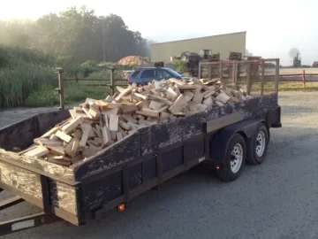

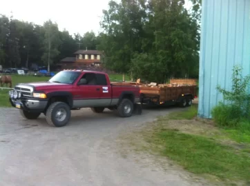

This is my trailer, compare 12k rated....
(edit)
Those pics aren't the best for showing size. The C channel is 6", .25 wall, so the front section is 12"
The first pic is loaded with 2 cords of wood. I have never run across the scales, but I would guess it's around 10,000lbs. I know the trailer gets a bit "tweaked" when it's loaded down, so it's some pretty decent weight.
