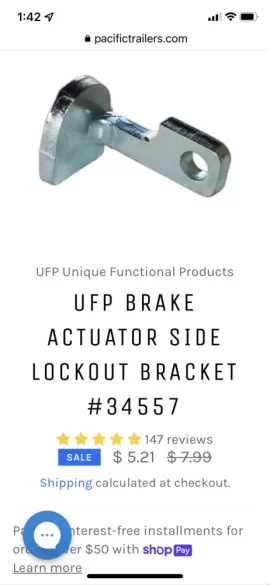

They’re every bit as maneuverable, but the tires on the axle with less weight (usually front on a properly set up rig, which sees equal distribution when loaded) will drag across the lawn or gravel, and tear things up a bit more.
I used to rent one pretty regularly, from a local rental company. 5k single axle with surge breaks and pintel hitch. Can’t remember the size, I was only using it for hauling heavy cast iron woodworking machines, which had small footprints but sometimes weighed several thousands of pounds.
I don’t miss driving anything with surge breaks. No fun backing those up a hill with a load!
I pull a boat a couple times a year (not mine) with surge breaks on the trailer. There’s a lockout pin that’ll allow you to lock the piston back so the brakes don’t fire when backing up. I don’t think it’s a unique tool, if I remember right it appeared on the trailer when a marina needed to do some work on it off season. Kind of a finders/keepers moment for him.
Reactions: stoveliker
EatenByLimestone
Moderator
Staff member
Yeah, here’s something similar for $5.
I remember renting one trailer (U-Haul, I think) that had a lock-out on the surge brakes. But the 5000 lb. single I used to rent from a local company had none. I had one frustrating event trying to back it up over a threshold into my driveway, when I lived on a busy 2-lane highway, which pretty much sold me on never renting one again.
