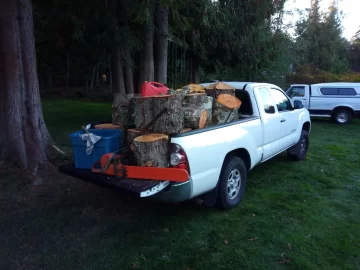

might look into Timbrens ( replace the bumper stops on the axle). There when you need them but do not affect unloaded ride. Never had a lot of luck with air gadgets- dang sets are pricy and always seem to develop some sort of leak.
Love the TImbrens. You're not fussing with compressors and leaking lines. My 2WD Taco only has about 1/2'' space between the Timbren stop and the axle so on rough roads you do feel a bit of road vibration in the truck - and on rough turns you'll get a bit of wheel hop. Small price to pay to regain steering control with a full load on board.
This is a pic without the TImbrens and about 750kg of road base in the box...
[Hearth.com] 2001 Sequoia and trailering firewood
This is two weeks later with the TImbrens installed and about 740kg in the box...
And of course with a couple loads of firewood...
[Hearth.com] 2001 Sequoia and trailering firewood [Hearth.com] 2001 Sequoia and trailering firewood
Wow. That’s ridiculous. According to the 2019 spec’s, you’re not even overloading it much, the listed payload is 726 kg. I understand they never die, and thus have gained a following, but I photos like that make me wonder why anyone would ever buy a Japanese truck.

The Colorado and Ranger have similar payloads and still squat. The two main reasons I bought the truck were fuel economy(4cyl/5spd gets 36 on the highway) and I was commuting 120km daily for work, and I wanted a vehicle that I could drive for 20 years and not have it nickel and dime me to death. It's eight years old, 150,000 km, and I haven't spent a penny on it except for consumables and a few aftermarket add-ons.
