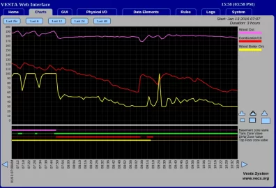

Wouldn't it be nice if a circulator could be programmed so that it would only send 185F water into your storage tank? It would speed up and slow down automatically depending on where the burn cycle was. Someday...maybe ...LOL
Something like this? Circulator speed is in percent.
[Hearth.com] Time to reach operating temps from a cold start?
Yeah, what type of circulator?
Grundfos 15-58, controlled with a Vesta. It's the wood boiler circ in the 'live' link in my sig. No fire tonight, though - we're skipping because we have enough in storage to last until tomorrow.
