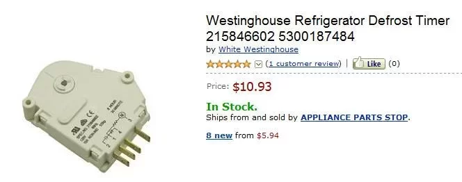

Hello BrotherBart
http://www.amazon.com/gp/product/B0...mp=1789&creative=9325&creativeASIN=B002ZNGBT4
Description
Frigidaire Westinghouse OEM Defrost Timer 215846602 NEW 215846605 8 hour 30 minute Defrost Timer
1st Pic below is a standard OEM refrigerator defrost timer.

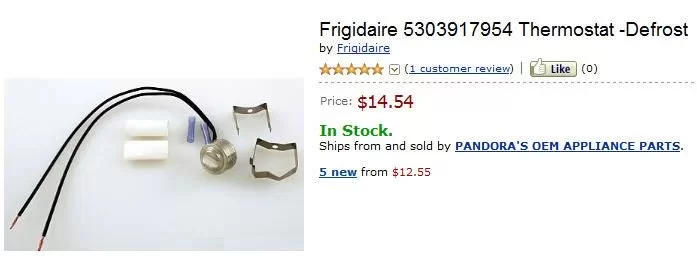

Also there is a thermostat
http://www.amazon.com/Frigidaire-5303917954-Thermostat-Defrost/dp/B002ZNE54W/ref=pd_sim_k_1
See 2nd pic below
Description
# - POPULAR GIBSON -STYLE THERMOSTAT WITH SPECIAL SHAPE TO FIT TUBING - CUTS OUT WHEN THE TEMPERATURE
# REACHES 55 DEGREES FAHRENHEIT AND KICKS IN WHEN IT DROPS TO 25 DEGREES FAHRENHEIT
Do you know how these work?
When turning the fridge AC off with a timer, the freezer will defrost naturally (Like my mother used to do!) instead of an expensive Heater coming to do the same job. Would that save alot of electricity????

The defrost timer stops the compressor and turns on the heating element. The defrost thermostat indicates when the evaporator area is above a certain temperature, indicating that the defrost cycle is done.
IMO, it would take month of Sundays for the evaporator to defrost naturally. The systems are designed to operate a certain way. I realize that the heating element uses power, but it also saves power by keeping the system working at peak efficiency. We can help by keeping the condenser coils clean.
I had a defrost timer go bad years ago. Of course, it stuck in the heat position, and the fridge actually got warm inside. That was the start of my education on how reefers work.

Well in summary, if a timer is used and the AC is cut off during a Defrosting cycle the freezer would be too cold and would take longer to come down to bring the evap down to temperature. That might save some electricity and money. However if the AC is cut off during the Cooling Cycle, the freezer would be too warm and get even warmer when the AC power is off. When the AC power comes back on, then the compressor would run a little longer to bring the temperature back down to where it should be. Using a little more electricity.
So turning the Fridge off for a long time would save energy if there was no food in there to spoil like on a long vacation.
In the short run turning the fridge off for a few hours would keep the freezer from being at the correct working temperature and may or may not save electricity depending upon what cycle is being interrupted.

That will save a lot of electricity if you don't mind your freezer compartment reaching 55 every week!
