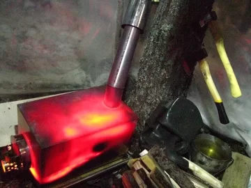

This is a Russian solution to -20 temps.
It’s glowing red hot. What in the world is that? An infinity stone? lol
Stainless steel camp stove.
