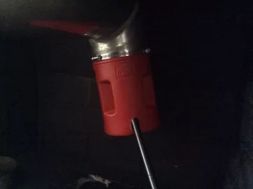

Today was a warm day so I took advantage and let the stove go cold. Cleaned ash, glass, etc. And decided to clean the flue as well. This is the third time using the Sooteater. The first was top down, and wasn't fun. My roof is steep enough that leaning my chest on the chimney and running the Sooteater isn't fun. So before I started burning this season, I ran the Sooteater from the bottom up. I had pulled the T at the bottom of my liner to do some work on it, so it was easy enough. But I just used a trash bag with a hole in it. The bag would wind up around the rods and bind. It worked, but not great. So today I devised a new system, and like it a lot.
[Hearth.com] Tip to aid bottom up Sooteater cleaning.
I took a tall Folgers coffee can and two spare hose clamps. After removing the clean out on the bottom of my T, I quickly realized that the very top lip on the can was keeping the can from sliding onto the T, so I carefully shaved that off and it slid right on. After fitting that, I had to drill a hole for the Sooteater rod. I don't have enough room to go into the bottom of the coffee can, so I went on the side right at the bottom. And this worked because it kept the ash from wanting to fall out. The hole does have to be a larger than the connecting knuckles of the Sooteater, so it isn't a perfect fit or anything. And going on the side a bit allowed a better angle for the cleaning rods to go in and come out.
Obviously you have to put the first section of rod into the flue first, and then get the rod to come out of the hole in the bottom of the can. After that I put on sections to run the brush to the top of the flue. Hooked on the drill and started to clean from the top down.
I took a crappy t-shirt and wetted it. Holding it against the can and around the Sooteater rod allowed me to clean the rod as it came out and keep most soot from falling out of the hole.
When I got down to the last section I had to pull the can. This is what I found.
Not a lot of soot. And most all was caught by the can. Here it is poured out outside.
Now, this wasn't squeaky clean. The last section pulled a bit of soot out into the old t-shirt. But not much. And I knew I wasn't going to fill the can..... if you think you might, this might not work for you. But I was pleased by this system. The only thing I could think to make it better would be to hook up a vacuum to the very bottom of the can to suck up the soot as it fall. But I kinda like to see what comes out, so I would have to devise a dry catch of some sort.
Anyway, I hope this helps someone. I sure did like not having to be on the roof, and how clean this worked. The wet t-shirt really helped both clean the rods as they came out and keep soot in.
Josh

I took a tall Folgers coffee can and two spare hose clamps. .....I had to drill a hole for the Sooteater rod. I don't have enough room to go into the bottom of the coffee can, so I went on the side right at the bottom. And this worked because it kept the ash from wanting to fall out. The hole does have to be a larger than the connecting knuckles of the Sooteater, so it isn't a perfect fit or anything. And going on the side a bit allowed a better angle for the cleaning rods to go in and come out.
Josh
Nice setup!
I am wondering, would it be any better to drill the hole in the coffee can at a higher point? If the hole was up higher you would still have the same access ( I think) and it would allow for more space for the soot to fall/accumulate.;?
Then the soot wouldn't come out with the rods because most of it would be BELOW the hole.
Maybe?
Nice setup!
Maybe?
Thanks. I think the reason I went low on the can was to keep the sweep of the rods into the liner more towards center. If you're up higher then the rod is closer to one side and less centered. But all setups are different so each will be a little different. The soot really doesn't fall out of the hole I have. The rag more cleans the rods as I withdraw, keeping me and the house cleaner. But if I have to make another can maybe I'll try a bit higher.
