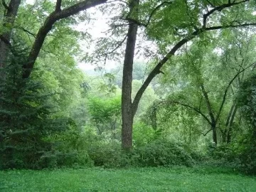

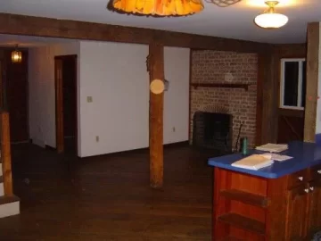

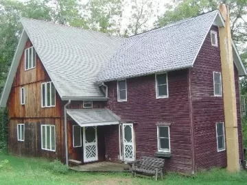

Thanks for the tips - you want pictures? - here you go:
These were taken when we first went to look at the property in the late summer. We fell in love with it that day.
I ride dirt bikes so trails are planned anyway - seems as though they will help serve my heating needs as well.
The masonry chimney that you can see attached to the old part of the house is not where the insert will go. There is another chimney on the other side that is out of view. It has 3 flues. 1 for the fireplace, 1 for the furnace/hot water heater (oil) and one for a side fireplace on the same floor.
The chimney on the old section will probably get a free standing stove and a hearth that I'll build from river rock collected from the property.
Thanks for your interest, any suggestions or thoughts with this setup are welcomed.
