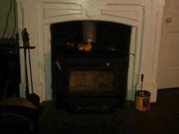

Congratulations! I understand your feelings as I'm a new burner myself ( sort of). Anyway, what kind of insert do you have? What are your outdoor temps?

Well I really, really wanted to heat the whole house with wood but in-laws bought a tiny insert. It's a Century CW2500. I was looking on CL for a used free standing but they unexpectedly bought us this. Really wanted more of a Cadillac wood burner but got a little Kia instead.

Congrats! Stick around and you will soon be a fire nerd yourself. What material is the mantel/trim made off? And do you know what is under the hearth?

Ahhh, not sure. You know what, I think it's wood. Woops. I think it's brick straight down, unless I'm confused about your hearth question. Sorry, I'm a wood burning idiot.
If that trim is really wood you should check the manual carefully. I am pretty sure you don't have enough clearance.
The hearth is the floor under and around the insert. If that is fully brick several layers deep you are fine. If it is just one layer over wood beams you are in trouble. Is there a basement below? Could you check the ceiling there?
From stove top to beginning of mantle thingy should be 10", I'm good there. Side of insert to side mantle should be 10" as well. I think I'm a little short there. The first white part is some kind of brick. I may have to cut out some of the side wood section for clearance.

Forgot the hearth. It's fully brick. I crawled under there a week ago.
