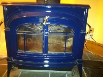

I just bought a Blue Vermont Castings Defiant Encore. It has a 8 " chimney .... I am going to put it in my house and dont know.... All the stories of puffing griddles, reducing to 6" ... I want to know if i put the right 8" chimney and dont like the stove, can I buy a 6" type chimney stove and hook it up to the 1800 dollar 8" chimney.... I dont want to buy two chimineys....... Its going to be a free standing corner set up going through two floors and a roof.

Thanks so much for your thoughts.... I am thinking long and hard. When I saw the photo on Craig s list, I said this stove is what I want. I like the looks. I really don't mind that it may use a bit more wood than something newer. However, I thought the brand was a good one. Now that I have this forum, my opinion must reflect that of the many, many bad reviews. Mine has a catalytic and that seems to not be a great idea. The one i have is really in good shape....This stove came from a house where the wood came wrapped in plastic and had a handle stapled to the top of the package. Very low hours, I paid 700 bucks.... Ugh I did not know until after I bought it that the 8" chimney is gone from the market I just don't want to get locked in to the 8" chimney. .

This stove came from a home where firewood came from Shop rite wrapped in plastic. No cracks anywhere, and no warping. I havent checked the cat yet, but plan on taking a look tonight. I don't need the stove right away as I have the hearth to build and the house has a oil burner with cast iron radiators. I was told by my local stove store how these Defiants can be a nightmare with the expensive repairs.
I paid more for it than most of the units I ran across - 700 but I think it will be a good choice. Its a later production (2190 model) and I think it has low hours. I dont mind messing with the thing while it burns , I understand that's part of the package with this stove.
