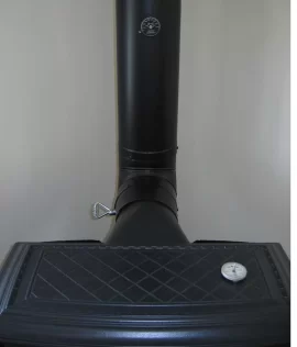

#2 - This will take a bit of finessing depending on the draft and stove. You may find the sweet spot is with the stack damper half-closed. So I would say start the fire with all dampers wide open. Then, once the stove is getting hot, (over 400?- your setting may vary), find the sweet spot at which setting the stack damper allows full regulation with the stove air controls. In our old installation with the 602, this meant shutting the stack damper closed, though it never really closes all the way. With the Castine, this is with the stack damper about half-closed.
#3 - If you don't have one already, invest in a stack thermometer. It helps one regulate the stove better and avoid running the stove in the opposite condition where the stack is always too cool.
Yes, I do indeed have a stack thermometer. It is located at about the same height as yours.
