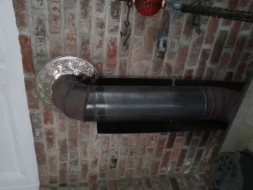

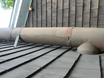

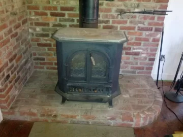

it's a brick hearth on the exterior wall on the exterior of the house. The hearth is in the corner and on the floor (see pics - srry they are sideways - can't turn them on this computer)
Inside wall is brick then drywall. Outside is wood shingle (see pics)

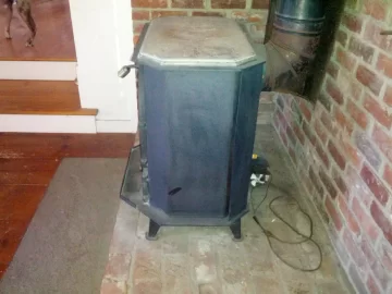

Below are pictures of the current set up - old wood stove (we will remove before install) on the hearth and wood stove pipe on the house side. We will remove the pipe, as well.

Hey SmokeyTheBear - it's a brick hearth on the exterior wall on the exterior of the house. The hearth is in the corner and on the floor (see pics - srry they are sideways - can't turn them on this computer) Inside wall is brick then drywall. Outside is wood shingle (see pics) He ended up giving us the price of p61a of $3599 - $200 ($100 harman coupon plus he matched it for another $100 off) = $3300 Total price installed (Stove, Installation (to drill through brick, install OAK, all venting) and tax = $4769 Unreasonable? He's on the way home for the holiday so he is going to go over the numbers with me on Thursday. I thought it would be over 4k, but I guess I wasn't expecting almost $4800. Was thinking more like $4300 or $4400. It'll be worth it, I'm sure. Just a big number right before the holidays Below are pictures of the current set up - old wood stove (we will remove before install) on the hearth and wood stove pipe on the house side. We will remove the pipe, as well.

Looks like a fairly straight forward install to me. Does your dealer know you already have a wood stove? The Harman OAK thimble with the OAK pipe might look a little funky up there though. It has sort of an angular "F-117" look.
I suppose you could put a plug in that existing hole and drill a new one. Maybe that's what your dealer was thinking as the install price seems high.
A coaxial pipe would work nicely with the existing hole.

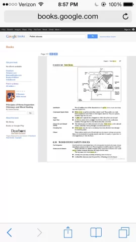

No there is no "Pellet Stove for Dummies" but I may refer you to google eBooks "Principles of Home Inspection & Wood Heating" by Carson Duntop Page117 Chapter 6 Wood Stove Section 6.9 Pellet stoves. Unfortunately the web preview does not show all the pages!
http://books.google.com/books?id=JFX3P-XuNagC&printsec=frontcover&dq=Principles of Home Inspection & Wood Heating&hl=en&sa=X&ei=8UK6UsbgK-ezsQS6yID4Bw&ved=0CEgQ6AEwAA#v=onepage&q=Principles of Home Inspection & Wood Heating&f=false
See pellet stove diagram below from eBook link above! Enjoy :)

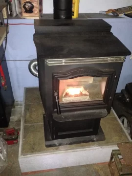

I have two stoves. One has an OAK, and the other was installed while I was out of town, and I foolishly allowed it to be installed without one (a dealer recommendation there, as well, which I can tell you often means little). Both stoves burn well. But the one without an OAK creates drafts near the floor (none with the OAK stove) and when we run the non-OAK stove the humidity in the house plummets (western CT probably has far greater problems with dry indoor air in cold weather than dampness).
I still use that non-OAK stove, but this is the LAST season without nm OAK on it (this is also the first!). I may even address that this season, depending on weather. After learning more and experiencing it first-hand, I've become an OAK-zealot. Take it from someone who has direct experience with both and avoid a mistake you will regret (I sure do). You DEFINITELY want an OAK.
