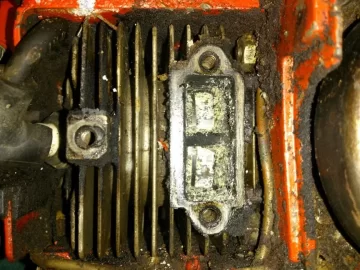

Took the muffler off and this is what I saw. I'm guessing this is a good example of what it shouldn't look like. There is a bunch of loose white/gray sandy material in there. Muffler itself looked clean inside. I'm guess I should pull the spark plug too, and add some sort of lubricant to hopefully loosen things up.
[Hearth.com] To rebuild or not to rebuild
I think that saw is pretty much toast. Lots of used saws out there that just need a little carb work or an ignition coil to be good runners.
SXLs are a dime a dozen, not worth saving if you ask me.
Can u even get a rebuild kit for that saw?? . I'd look for a used husky or stihl. You can prolly pic up one for less than $100 as a rebuild or parts saw.
And something built within the last 20-25 years is going to have decent AV, a chainbrake, and perform much better than that old SXL. I like old iron, I have a couple dinosaurs myself. Would I use them as my go to firewood saw? Heck no.
