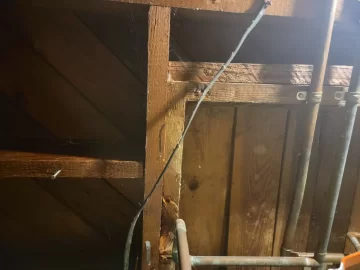

That's directly below where the insert sits.

It's hard to say exactly where the brick chimney begins, I suspect that the bulk of the insert is behind that block wall and the part of the insert that sticks.out, about 10 inches, is on the wood floor. It's a partial basement so behind the block wall is dirt and then a slab. The masonry runs up through the middle of my house as this house had some additions built on over the years

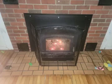

Can you post a picture of the fireplace and hearth where the Buck is installed?

No good, the installation manual says compliant masonry fireplace built to spec, but since the actual stove box is resting on the thin part of the cement hearth pad with no 8" solid masonry under its null, the 3/8" hearth was referring to that space infront of the loading door.

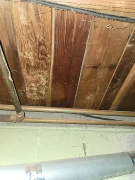

So how would something like that be fixed? I mean, that's the floor.
Are you saying that what we are looking up at in the basement is the sub-flooring and the same all across the basement ceiling? I hope not. The hearth for a masonry fireplace needs to be made of a brick, concrete, stone, or other (approved, listed) non-combustible material. The hearth slab needs to be at least 4" in thickness, it has to be supported by noncombustible materials or able to carry its own weight. It need to extend at least 16" in front of the fireplace opening or 20" if the fireplace opening is more than 6 sq ft.
Here is another pic. At first glance I thought it was the same but it's a but different. The part on the right is under the hearth and its a bit lower, maybe 3-4 inches. The part on the left is the subfloor.
