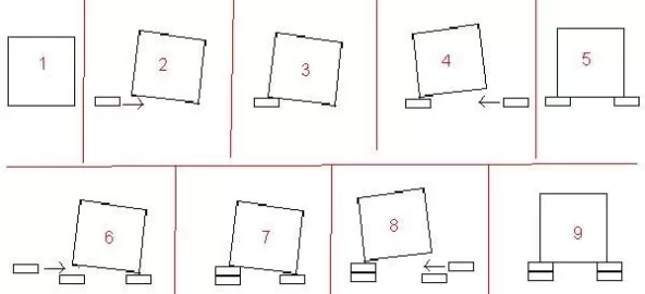

re: getting something heavy into the bed of a truck.
I helped the guys do this when they moved the old coal burner converted to oil burner furnace from my basement. I was surprised that they've have to get 100 guys to run over and help them move, well, with something like this it only takes two....
Forgive me if you already know this method. It's very elementary, but you'd be surprised how many people don't think to use it....

I thought about doing something like that with the Vigilant when I bought it last year. I was still concerned I would knock it off the stacks when I tried to move it the last time to get it into the truck. Says more about my abilities than the system itself :)
Simple, elegant solution there, for sure. but i'll share how my guy got my Heritage onto his truck, off his truck, across my dirt/gravel driveway, up 5 steps, and into my living room - all by himself!
He had a powered, stair-climbing appliance dolly. It has fork-truck outriggers, leans back on a perfectly balanced fulcrum, climbs the stairs beautifully using an on-board car-battery powered motor, and its big, rubber wheels don't care what very solid surface they roll over.
They are routinely rentable from home stores. VERY nice tool.

This is how we jacked up the spent nuclear reactors from submarines so that we could slide them onto a barge. Stacks of Oak boards.

Same story here except it's not nuclear reactors, it's something else, and instead of submarines, it's something different, and instead of a barge, it's not, and we used pine. But other than that, same thing.
Got any pictures of that HB? sounds like it would be cool to see.
