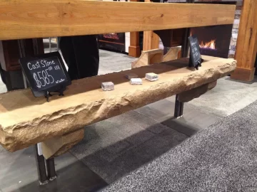

Here's a neat mantle is saw at the trade show. It's made out of lite concrete.
  • [Hearth.com] Too High...
Looks nice, but the price is a bit steep for my pocketbook!

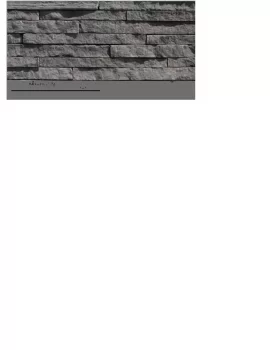

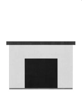

Have decided to forgo the hearth and just use hearth stone pavers. Here is a graphic I made with the colors and the correct measurements. Also a image of the grey stone. Will try the mantle at different levels when we do the stone work
[Hearth.com] Too High... .
