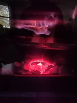

Here is a picture of the firebox 3 hours after adding 3 large hardwood splits. After I added them I turned air to half right away and the after they were starting to catch I turned air to low and engaged catalytic. It ran really well for 3 hours but I checked back and now it was like this with cat thermometer right on edge of too hot.

Doesn't look bad. A new cat is going to run hot for the first several fires.
