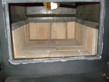

I built a stove and called it a Great Gma. It was the width of a Gma and the depth of a Papa. It was huge to say the least. If any pop up for sale I made it. My neighbor bought one and he had a fire going, filled it and left it alone since it warmed up some. 3 days later he was going to start another fire and it still had enough coals in it to get it going on its own. Nice!
Great Grandma

I'm taking a collection for you to go over and finish the ash fender so I can cut back on my meds.
LOL we have 2 different styles :) I changed the ash fenders when I moved the machine we used to bend the channel. They are not what your would want that is for sure, not this way but man are they easier. Since that is the one i built for the stove in my avatar, I guess they will have to like it.
Don't tell anybody. :)
