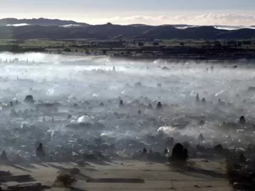

Not uncommon in an area where smoke is trapped in a geographic location that is prone to smoke buildup in winter due to temperature inversions. When hundreds or thousands of people start having health issues due to smoke, it becomes a public problem. Libby, MT, the Puget Sound region, and parts of VT all have this issue.
