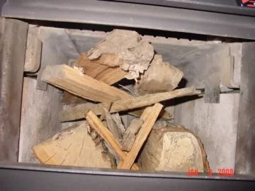

Top down for two seasons only way to go. Load the stove, put in a 2"x4" piece of fire starter on top and let it go. Within 20 minutes you have it all ablaze.
This is sort of a sandwich with fatwood filling. When I started burning I thought I needed fatwood, but seeing as we never let it go out I don't.
Anyway, I still have my super cedar fire starter samples, and that's what I used this year. A quarter of one as sandwich filling and off it goes.
I have never had difficutly getting a fire going- big ones on the bottom for duration, little ones in the middle for a fast take off, and big ones on top again to keep it going after the little ones are gone.
Piece of cake :)
