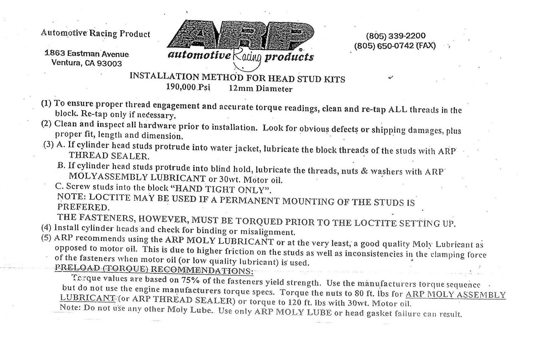

In general, a lot of times people get themselves in trouble w/ or w/out a torque wrench for using a tool that is too big for a job. Just because someone has a 1/2 in drive socket that goes down to 10mm doesn't mean that they should use that 1/2 in drive ratchet for tightening a 10mm bolt. This large tool makes it very easy to over tighten.
Along those lines, even if a torque wrench is used there are right and wrong ways of using them. Just because a torque wrench is stated as having a range of say 25 ftlbs to 250 ftlbs, doesn't mean it's a good idea using it to tighten something at 25 ft lbs. Even if the tool itself is accurate, it is often times difficult to use it accurately! If there are inaccuracies, they will really become apparent in the low range of a torque wrench's range where a long handle can make it very easy to over torque something as many will feel quite vague here and there is less room for error.
Additionally, how you treat a nut going on a stud or a bolt will also change what torque it should be installed to. For example, if using moly lube these (referenced below w/ a link since it's blown up large) head studs get the nut torqued to 80ftlbs, but if you use 30wt motor oil, you need to torque to 120 ftlbs! That is a HUGE range based on a seemingly very small difference on brand new parts! Now try applying torque settings to bolts other than very important internal engine components and slight corrosion / slightly damaged threads will make the original specs obsolete.
http://www.enginemachineservice.com/2074202spec.jpg
