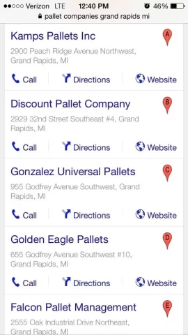

Also check out the area for a Pallet Manufacturer....lots of cutoffs for free there...

Found a place in GR that has cheap pallet scraps. Said the sell them by the "bunk" I guess its a pile like 4X4X3 for $5. Not sure if that's on par with other places yet but I am calling around. Stee and I are still diagnosing the electrical problems with my unit and I have an electrician coming out tonight to tell me why we fried 2 control units this weekend. I do have heat by running my pumps full time and just keeping a fire in the box, it just takes forever to heat up and I have to constantly monitor the water temperature with a temp gun. Better than freezing!
