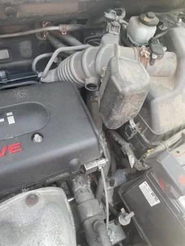

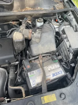

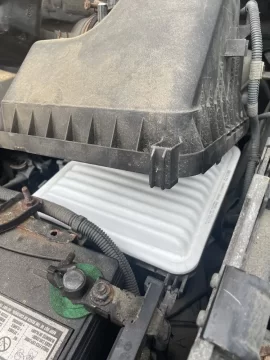

In this case I blew out the engine air filter and filter box and bingo it went right away as soon as I started the car. When it happened again I replaced the air filter but the lights were still on because the hose attached to the air intake fell off! After reattaching the hose, I had to drive the car around town a bit and then the lights went off!!
Pic 1 - The 3 warning lights Check Eng VSC ( Vehicle Stabilization Control ) and 4WD
Pic 2 & 3 Air filter box & Air cleaner
Pic 4 - New air cleaner VS old air cleaner
Pic 5 & 6 - Hose that fell of air intake ( With this hose off, the car idled rough! )
Pic 6 - new air filter from Car Quest $14.49 for the fix. :) Which maybe just for 2006 - 2008 RAV4s?

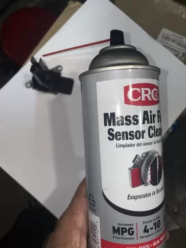

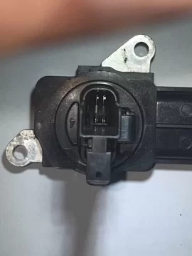

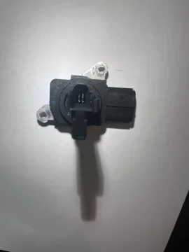

I finally got a chance to clean the MAF sensor. That is the Mass Air Flow sensor with the special cleaner. Those wires in there that sense the air are very thin but after I was don they did look clean and shinny so that should help?
Pic 1 - MAF removed from the car air cleaner intake hose
Pic 2 - Before cleaning
Pic 3 - After cleaning
I also did the side wires as shown in the video link above. They looked good to begin with so I did not post those pics.
